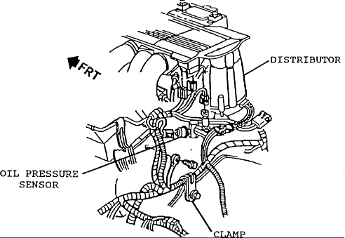

Elenco dei punti di massa:
Ground G101: Near LH Side of Battery, on Frame LH Rear of engine
Ground G104: LH Rear of Engine
Ground G105: LH Rear of Engine
Ground G106 (5.7L/V8-350 VIN 8): LH Rear of Engine, Near Oil Filter
Ground G106 (5.7L/V8-350 VIN J): RH Rear of Engine, on Bell Housing
Ground G107: LH Rear of Engine, on Bell Housing
Ground G108: LH Rear of Engine, Above Top of Bell Housing
