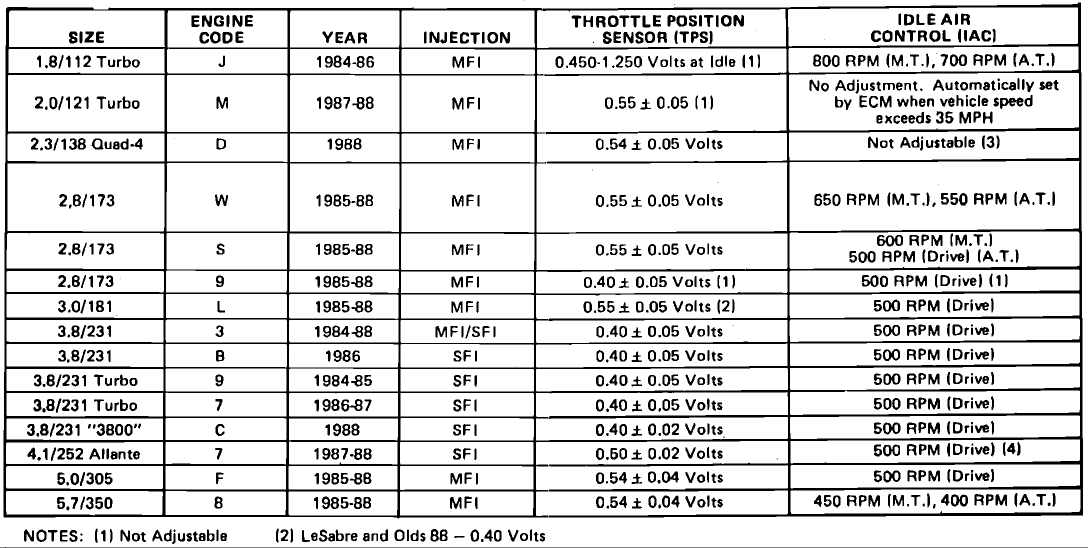

    Non ho ben presente come siano le viti vicino al debimetro. Però non mi risulta si regoli da lì - ma posso sbagliare.
    Dai dati che ho io questa è la procedura per regolare il minimo, sono elencati più modelli di C4 - vedi quella che fa per te.
    Purtroppo non posso darti il link del sito.
    Saluti
    Idle Speed
    Notes
    Midpoint of range given is the preferred setting speed.
    Idle speed is adjustable only if a specification is given under "Minimum Speed".
    1982-86 All W/single TBI: Gain access to throttle stop screw. With engine at operating temperature, disconnect idle air controller and install special tool to seal idle air passage of throttle body. Turn throttle stop screw to specified minimum speed value.
    1982-84 All W/dual TBI: Disconnect IAC electrical lead. Start engine and let idle stabilize. Remove cap on rear TBI unit and connect a water manometer. Adjust minimum speed to achieve 6" H2O on scale in drive. Reinstall cap on rear unit and remove cap on front TBI unit. If reading is not 6" H2O, adjust balance screw on linkage. Disconnect manometer and set minimum speed on rear TBI unit to specified value.
    All 1982-86 W/FI except TBI; 1987-90 All W/FI & TBI when specifications appear in Minimum Speed column: Ground diagnostic lead and turn ignition on for 30 seconds. Remove IAC electrical lead and remove ground from diagnostic connector. Start engine and set minimum speed to specified value.
    All carbureted W/ISC: With engine at operating temperature, turn ignition off and disconnect harness from ISC. Apply 12 volts (+) to third terminal from top of ISC (C), and ground the fourth terminal from top (D) only long enough to retract ISC plunger. With engine running, set minimum idle to specified value by adjusting carb base screw. Apply 12 volts (+) to fourth terminal from top of ISC (D) and ground the third terminal from top (C) only long enough to fully extend ISC plunger. Set maximum speed to specified value by turning ISC plunger head.
    Never apply voltage to first two upper terminals (A & B) or damage to the unit will result.
    All carbureted W/ILC: Disconnect and plug vacuum hoses at EGR and canister purge valves. With engine at operating temperature, remove vacuum hose from ILC and plug. Set maximum speed to specified value by holding hex nut and turning plunger shaft. Reconnect ILC vacuum hose and check that minimum speed is at specified value. To adjust, remove rubber and metal plugs from rear center outlet tube, insert a 3/32" allen wrench. Remove ILC hose and plug. Connect a remote vacuum source and apply vacuum to the unit. Adjust carb base screw to obtain specified shutdown value.
    Fast Idle Speed
    Notes
    Fast Idle speed is controlled by the Electronic Control Module (ECM) and is not adjustable.
    Minimum Air Rate - Fuel Injection Only
    Notes
    Throttle Position Sensor and IAC Specifications
    Idle speed is speed is controlled by the ECM through the Idle Speed Control motor and is not adjustable. The minimum air rate is adjustable as follows.
    Ground diagnostic terminal, turn ignition on, but do not start engine.
    Wait 45 seconds for IAC to fully seat, then with ignition still on disconnect IAC connector.
    Disconnect the distributor set timing connector.
    Start engine and allow engine to go into "Closed Loop".
    Remove ground from diagnostic terminal.
    Adjust idle speed to specifications using throttle stop screw.
    Turn ignition off and reconnect IAC connector.
    Adjust TPS voltage if necessary: With ignition "ON" use a scan tool or 3 jumper wires to adjust TPS sensor to correct voltage specification. Tighten screws, then recheck reading to insure adjustment has not changed.
    Start engine and check for proper idle operation.

    ...grazie Cristian ... faccio qlc prova e t faccio sapere.
    Cmq la mia '88 monta una TPI come iniezione.
