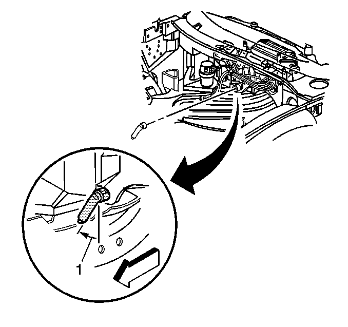

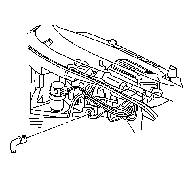

    vedi se così va meglio...
    PS: uso abitualmente manuali in inglese perché sono più precisi e completi.
    Ho supposto la tua sia un MY 2000, in ogni caso non cambia nulla.
    Saluti
    Document ID# 624597
    2000 Chevrolet Corvette
    Evaporator Drain Hose Replacement
    Removal Procedure
    11,68KB
    Caution: Before servicing any electrical component, the ignition key must be in the OFF or LOCK position and all electrical loads must be OFF, unless instructed otherwise in these procedures. If a tool or equipment could easily come in contact with a live exposed electrical terminal, also disconnect the negative battery cable. Failure to follow these precautions may cause personal injury and/or damage to the vehicle or its components.
    Disconnect the negative battery cable.
    Remove the battery. Refer to Battery Replacement in Engine Electrical.
    Remove the battery heat shield. Refer to Battery Heat Shield Replacement in Body Front End.
    Remove the evaporator and HVAC module drain tube from the HVAC module.
    Installation Procedure
    12,23KB
    Install the evaporator and HVAC module drain tube to the module; orientate the drain tube to contact the dash panel as shown (1).
    Check to be sure that the drain tube is fully seated to the HVAC module.

    grazie christian se stato molto gentile,era il tubo otturato,ora è tutto risolto,ti chiamo per il prossimo tagliando,grazie mille
